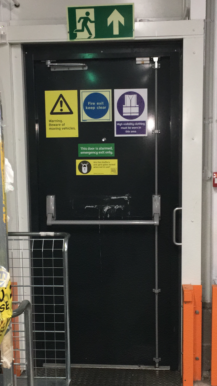

March 9, 20197 yr comment_13702 Hi everyone, thank you so much for sharing your knowledge and wisdom. Was wondering if I could just pose my current issue. I work in a warehouse and we have a door the drivers use to enter when they've parked up. The wind is vicious and often slams the door if just left open so I've put a tie outside to keep it hooked open. I've been told by certain people this is not allowed. It is marked as a fire exit and kept clear of obstacles but, is this a fire risk to keep it open? Report
March 10, 20197 yr comment_13714 Only if it is required to be a fire door which is not common, the door in the image appears not to be a FD30 door which is the norm and it is quite acceptable to hold it open, the only concern would be security. Report
