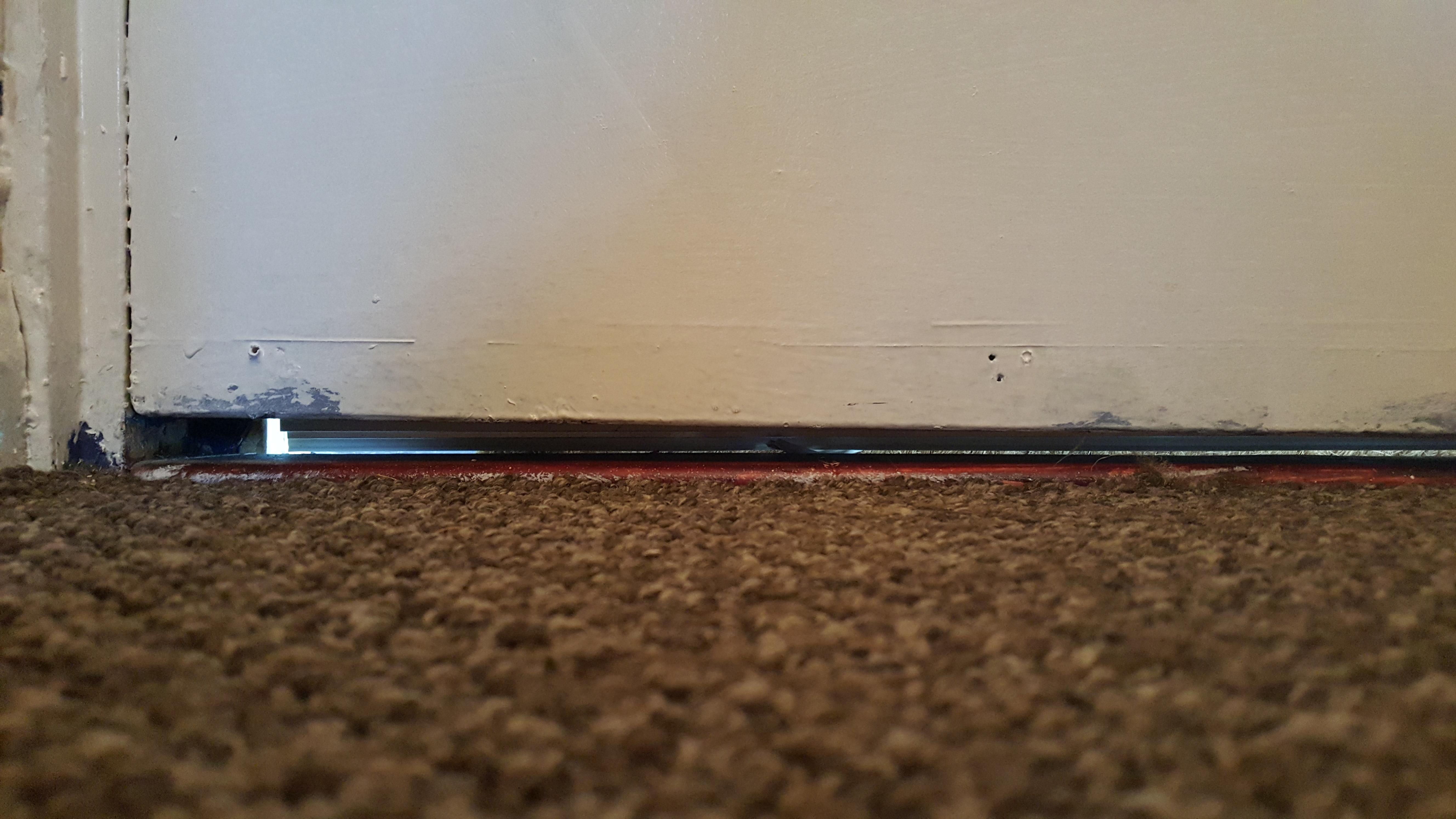

December 5, 20187 yr comment_13097 I am a new tenant and I have a one inch gap (not straight) under the external front fire door. Can the landlord cut more from the bottom to make it level and then fix a longer piece of wood on? Report
December 5, 20187 yr comment_13100 Is the door square with the stile and it is the floor that is sloping or the reverse. Report
December 6, 20187 yr comment_13105 You can add a hardwood lipping to the bottom edge of the door. But if the floor is not level the hardwood lipping my need to be 'planed-in' to suit, also the door may bind on the floor due to uneven floor levels. I would start by checking floor levels and would first consider fitting a threshold strip to the floor and then deal with any remaining issues with the door leaf bottom edge. Report
