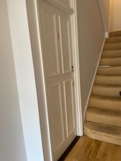

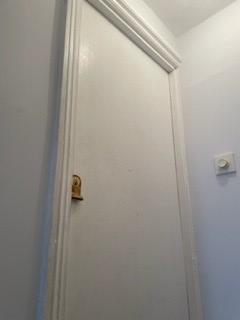

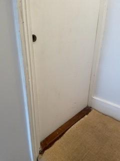

August 18, 20233 yr comment_38152 Hi. I own a flat and share of freehold for a converted Victorian house (1970’s conversion) with two flats. The common area includes a small hallway with door to flat 1, and flight of stairs to landing and door to flat 2. As co-freeholders (owners of the two flats) we have recently completed the fire risk assessment for the common area. The FRA recommends FD30S fire doors to each flat, complete with self-closers - consistent with guidance, and in line as far as I can see with the implied (or explicit?) requirement for closers in the recent 2022 fire regulations. However adding a closer to flat 2 will create a cumbersome entrance/exit as the door is on the original landing at the top of the first flight of stairs and immediately through the door is a second flight with corner stair where the door opens. The door opens barely to 90 degrees. Going though, for example with shopping bags or any item, will be probably be difficult and cumbersome against a self-closer. From my perspective the risk of not having a self-closer is negligible, as 1) flat doors are normally closed and this is easily self-managed by two flat occupants using a single small entrance hall area and 2) doors are always closed when a flat is unoccupied and at night time i.e. when the risk from a fire is greatest. Hence the ‘cost’ of adding the closure would appear to be disproportionate to any risk reduction gained. So my questions. Given the risk assessor has inevitably made a recommendation in line with guidance (that applies to a minimum of two flats, but is clearly designed for a larger number of dwellings) can we as co-freeholders make the case for not adding self-closers and record this appropriately- without being at risk of non compliance/conformance to relevant guidance or regulation? Does the relevant guidance (LACoRS?) allow for this assessment and decision making? From my reading it appears contradictory, saying it is only guidance in the intro sections but in section 21.5 says flat entrance doors will always require self-closers. Many thanks for any assistance. Report
August 18, 20233 yr comment_38162 No, it's been a key principle in guidance since 2011 that the self closers are fitted. Many deaths at Grenfell were attributed to missing or non working self closers allowing the internal escape stair (not directly affected by the cladding) to become impassable as it quickly filled with smoke from all the open doors. The guidance when it comes to residential is increasingly more than just a suggestion as it now has special legal status: (1A) Where in any proceedings it is alleged that a person has contravened a provision of articles 8 to 22 or of regulations made under article 24 in relation to a relevant building (or part of the building)— (a)proof of a failure to comply with any applicable risk based guidance may be relied on as tending to establish that there was such a contravention, and (b)proof of compliance with any applicable risk based guidance may be relied on as tending to establish that there was no such contravention. If you don't follow the guide you have proven your guilt! The guidance is quite generous in smaller blocks allowing older fire doors to be retained but will not move on self closers - too many deaths associated with open doors (even before Grenfell) There are lots of options to make a self closer less burdensome - delayed action closers, swing free closers, etc Report
August 19, 20233 yr comment_38182 Anthony, many thanks for your response and assistance. It’s interesting to see the emphasis / legal status given to the guidance in the 2021 fire safety act. The guidance now seems essentially to be prescription where directly applicable (to premises types etc.). And with regard to door closers it looks to be just that, a must for flat doors off a shared entrance/ escape way. (I suspected was the case even for small conversion - but wanted to check!) Thanks also for the suggestion to look at different closer types, hopefully there will be a good solution to retain ease of use. Kind regards. Report
September 3, 20233 yr comment_38430 Anthony, I have started enquiries with contractors. It is sounding like a full fire door set is required, to provide a certified FD30S door. Whilst the current doors fit tightly in the frame and are very solid and I think likely to be fire resisting for at least 30 mins (and likely to be a fire door standard at the time - the conversion was by a housing authority), we do not have any information on the doors or mark on the doors which are fully painted. Some photos attached. So far, I've been told to expect a quote of around £2,800+VAT for each door. What's more, the ripping out the of the current door frames will lead to redecorating work (plastering and painting) and probably not insignificant cost. It seems a tremendous shame to rip out two solid doors and frames at such expense and rework; versus an upgrade of the existing doors with the required seals, hinges, locks, closer. Above you said that the guidance is quite generous in smaller blocks allowing older fire doors to be retained. Might this be applicable in our case - given the fitting date of the original doors, and no available door certificate - and if so, could you point me please to the guidance that could support? (I think I know the answer already!). Kind regards. Report
