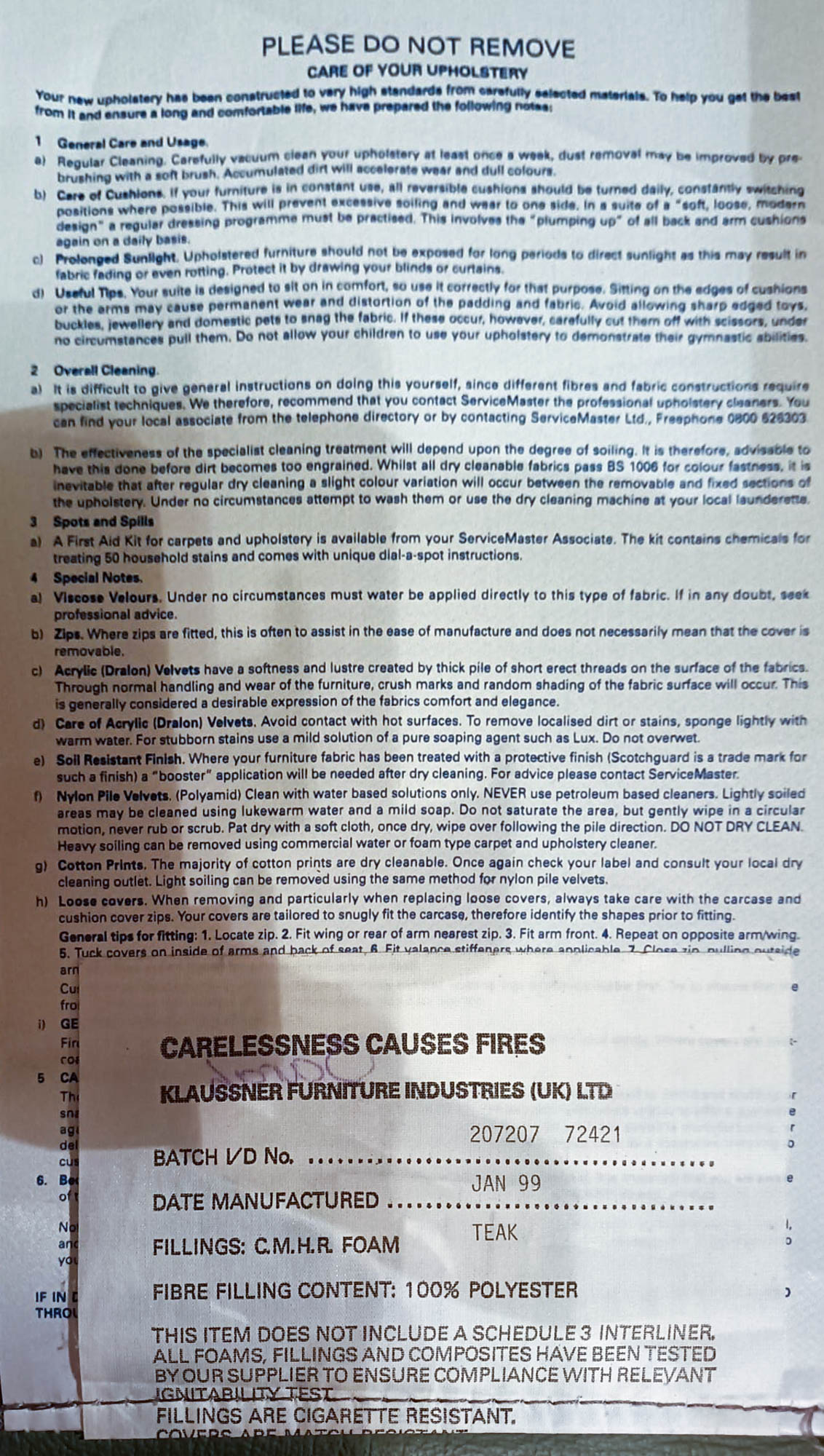

Hello, like many others I'm here to try and discover if I'm okay to sell a second-hand sofa on eBay (and if it doesn't sell to furthermore ask whether it's likely to be accepted by a charity shop.
I've attached a photo of the label which is affixed to the base, underneath the cushions. Most of it is care + cleaning, but the extra part speaks of "tested to ensure compliance"...
Is the labelling I have found acceptable for eBay sale and/or charitable donation please?
If you are a private seller, then the regulations do not apply to you, it is really down to the buyer if they want to buy it or not, the good news is, the smaller label is a "fire label"
