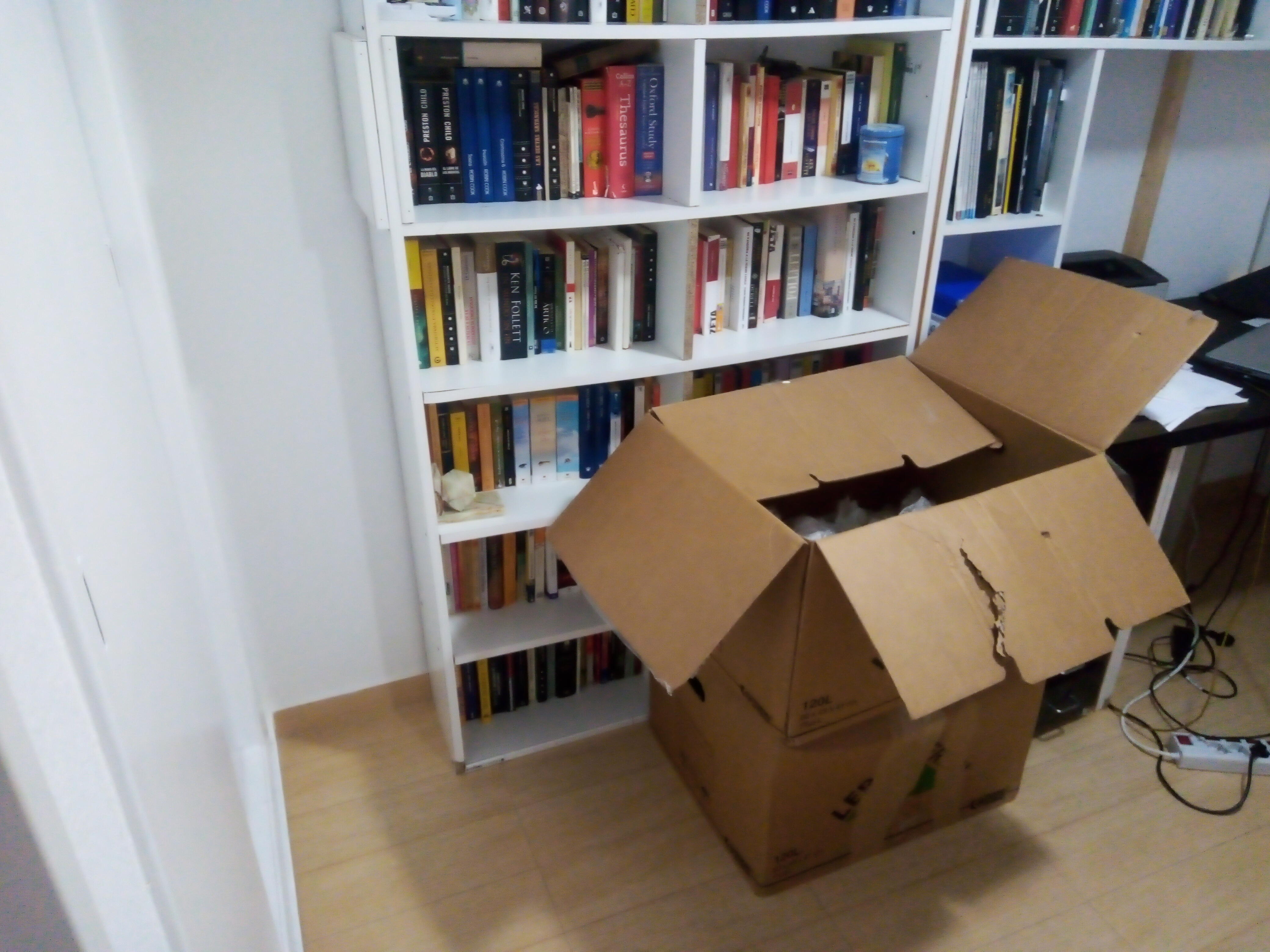

July 13, 20215 yr comment_20766 Good afternoon I have a small problem as I need an extinguisher for live electrics and I don't know if choosing water mist or co2 for computer equipment, I have 3 foams in my home (2l abf in kitchen, 6l abf in living room and an ordinary 3l foam at my bedroom I've also got fire blankets first aid kit and smoke alarms , however the co2 I want to buy has a lot of downsides starting that im afraid it can lead to asphyxiation, is it dangerous to install a co2 extinguisher at home ? Thanks very much. Regards. Ps: is for a study and computer room I'd like to put it behind the shelve on that small room. Report
