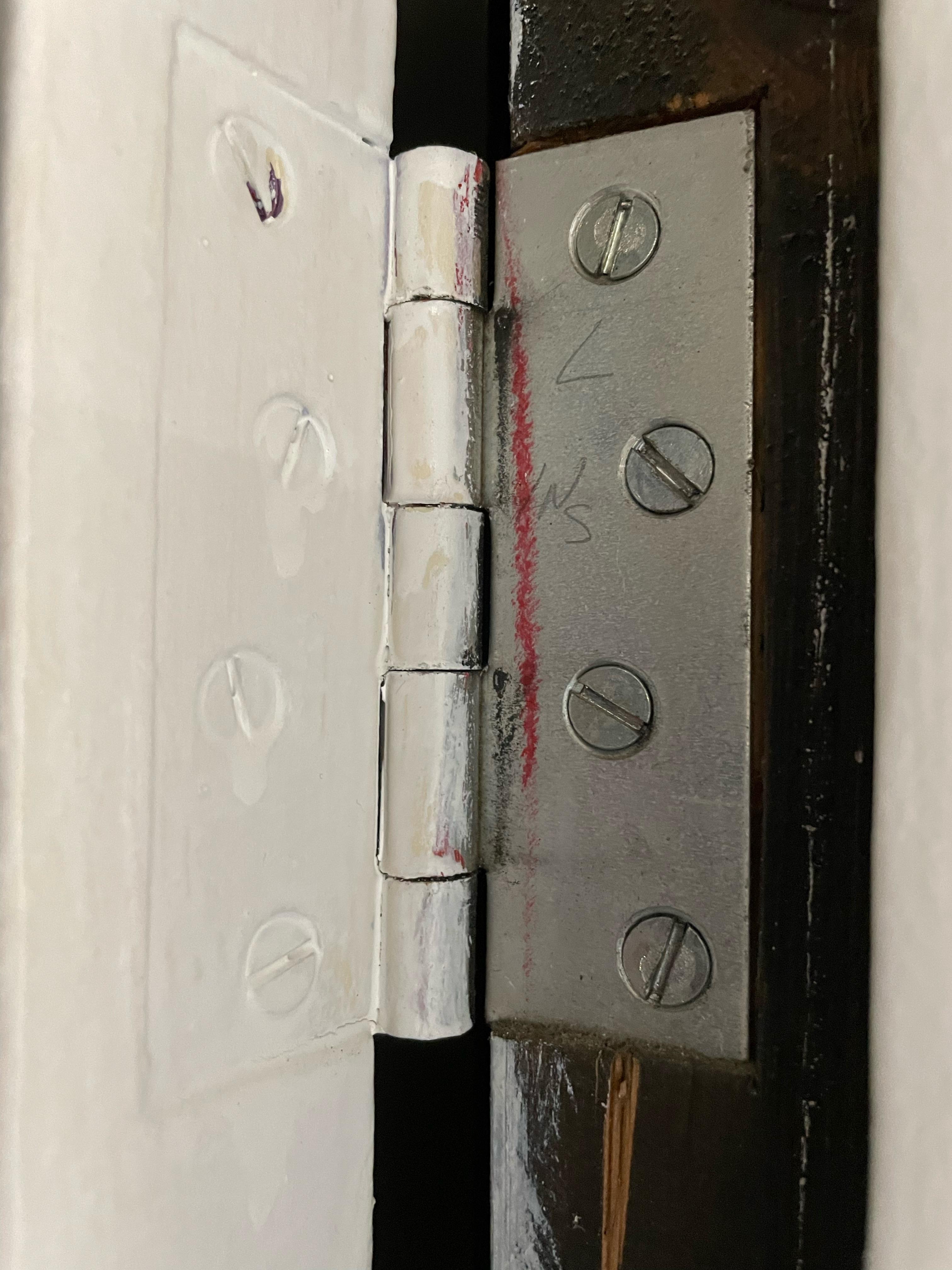

April 15, 20242 yr comment_42356 Hi, I live in a flat built in 2018. A recent fire door surveyor told us that our locks and peepholes do not comply as they are not intumescent. We have also been advised that the hinges do not comply as they are not kitemarked. Is there a legal obligation to replace any of this? Would these hinges pre-date the CE marking requirement? Thanks! Report
April 17, 20242 yr comment_42374 2018 is very recent in terms of timber-based fire door Standards. It may well be the case that the door manufacturer's fire performance certification requires that the hinges be UKCA or CE marked to the correct fire rating and durability rating in accordance with BS EN 1935: 2002. Similarly, the same door certification may require that the lock/latch-set has intumescent protection and the security viewer too. Contact the fire door surveyor, they should be able to provide the product certification details for the door and the specification for the hinges and intumescent protection gaskets. Report

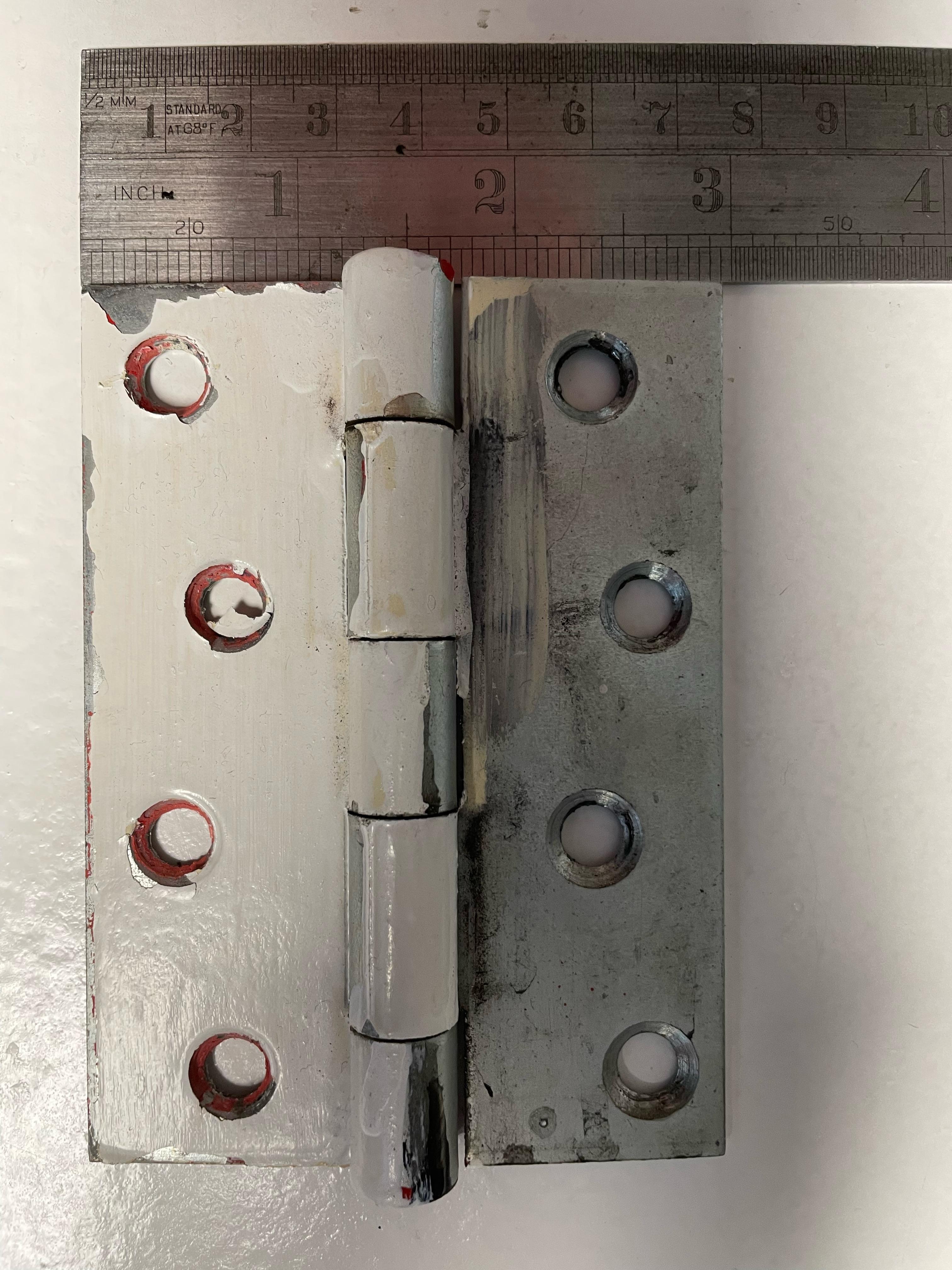

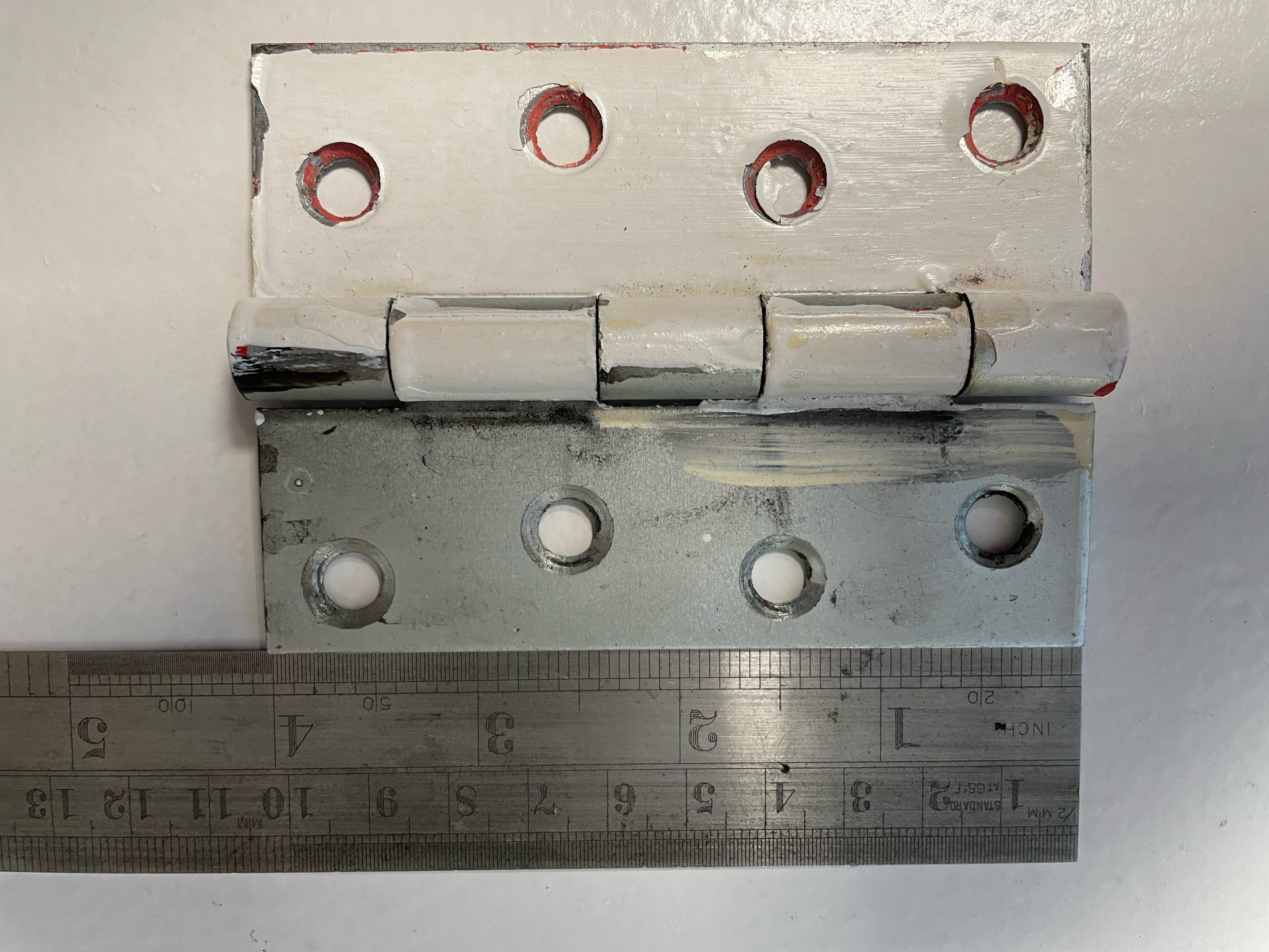

June 20, 20242 yr comment_43383 I work in a school and we have just had our annual fire door inspection. On the inspection they raised that our hinges are Grade 11 BS EN 1935 and should be Grade 13 BS EN 1935:2002. Can you advise if I need to replace every hinge within the school with the new grade and replace each time there is a new grade? Report
June 24, 20242 yr comment_43422 Grade 11 hinges are the minimum recommended for fire resisting doors. Therefore, your fire door inspector should be clear about the reason that they have recommended Grade 13. More info at: http://firecode.org.uk/Code_of_Practice_hardware_for_fire_and_escape_doors.pdf see section 2 for hinges Report
