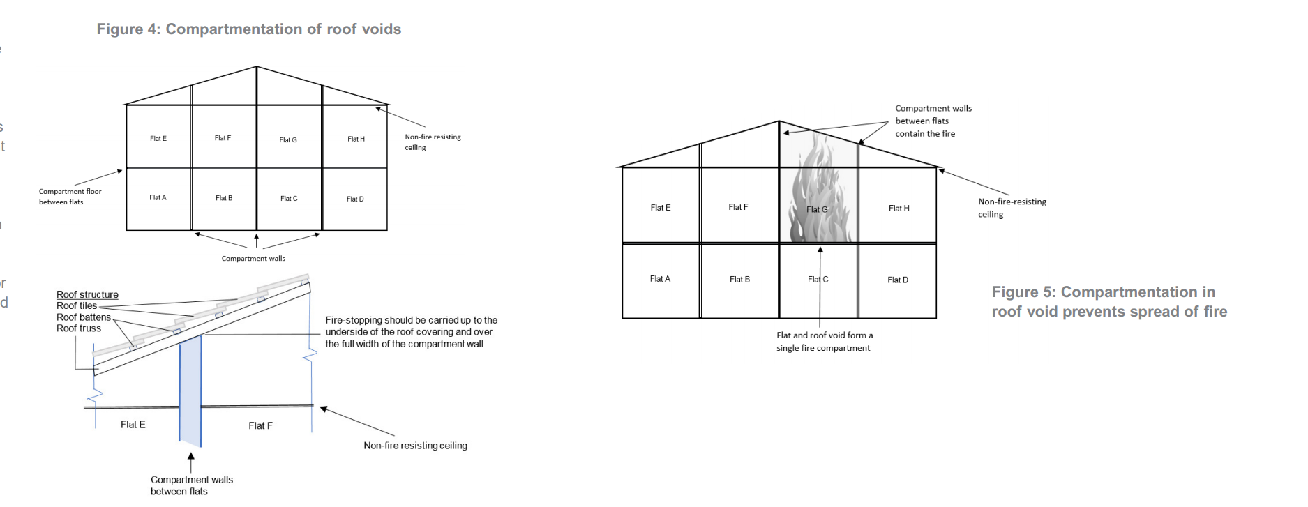

November 14, 20205 yr comment_18462 I am doing some work on a block of flats and double fire boarded every ceiling I am just checking do I need to double board the ceilings in the the loft area because there is no one living above ? Report
November 17, 20205 yr comment_18487 Usually for lofts instead of fire resistant ceilings below you continue all the fire rated walls below up to roof eaves level: Report
