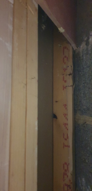

May 11, 20215 yr comment_20063 Hi there. I have an electrical riser cupboard (with BWF FD30S door on every floor) in a 3 storey (2005) purpose built block of flats that is not lined on the internal side. So you can see the timber studwork on the inside. Am I correct in thinking that it needs fire boarding on the internal side? Thanks in advance Report
May 15, 20215 yr comment_20107 A full height riser needs needs a minimum full half hour standard separation internal and external so I think you are correct. Report
