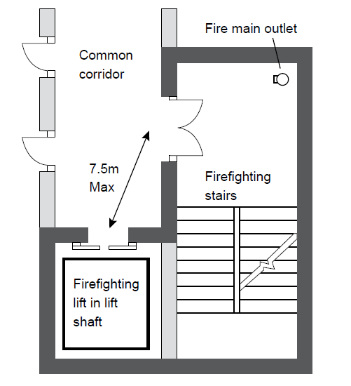

November 7, 20224 yr comment_30959 Usually you's see it, but it's not always been the case. Even now fire lifts can open into the corridor as long as they are within 7.5m of the stair door The shaft will generally always be protected in relation to the walls, often being brick & block, the vulnerability being the doors , which whilst some will give 30 minutes fire resistance are poor at stopping smoke. In some buildings in the past it was common to fit a self closing fire door in front of the lift opening to overcome this, particularly with concertina and open lift car doors, but it's less common in flats as they weren't covered by fire safety legislation until 2005 Report
November 8, 20224 yr Author comment_30983 12 hours ago, AnthonyB said: Usually you's see it, but it's not always been the case. Even now fire lifts can open into the corridor as long as they are within 7.5m of the stair door The shaft will generally always be protected in relation to the walls, often being brick & block, the vulnerability being the doors , which whilst some will give 30 minutes fire resistance are poor at stopping smoke. In some buildings in the past it was common to fit a self closing fire door in front of the lift opening to overcome this, particularly with concertina and open lift car doors, but it's less common in flats as they weren't covered by fire safety legislation until 2005 Thanks for this. Seems crazy, as any other shaft penetrating sleeping compartment floors you would expect to see fully protected. I visited a large hotel the other day and the lift (non- firefighting) started at reception level and stopped on the sleeping corridors of all upper floors. Adjacent to all the bedrooms, no lobby protection. This is accepted? Report
