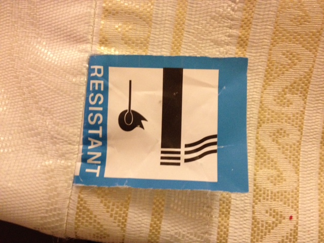

January 15, 201412 yr comment_6011 Hi there, following a recent tv programme highlighting the boom in false fire safety stickers I thought i'd check my just over a year old mattress which was quite cheap and has already bust springs etc. I have attached a photo where i believe a part of the sticker to be missing or sewn in to the bed, do you agree this is probably faulty. The ebay user has since closed their account so i am not sure what I can do at this point. Thank you for your time and help, Hannah Report
January 15, 201412 yr comment_6013 I am afraid there is no legal requirement for manufacturers to fix label to mattresses the guidance says, The fire safety of all mattresses (of any size), divans and bed bases is controlled by both the Regulations and the GPSR. Only the filling material (foam or non-foam) contained in a mattress, upholstered divan or bed base must meet the Regulations. However, the fire safety of the complete product is controlled via the General Product Safety Regulations 2005. The normal route to achieve legal obligations is to have products evaluated against the British Standard best suited to product safety. In this context, a finished mattress and mattress topper, divan or bed base should comply with the low hazard category of BS 7177. There is no formal scheme for proving compliance with a Standard and a supplier can simply claim compliance. However, the accuracy of such a claim needs to be justified when challenged by purchasers or Enforcement Authorities. Check out http://www.fira.co.uk/document/fira-contract-flammability-guide-october-2011pdf.pdf and http://www.fira.co.uk/document/fira-flammability-guide-october-2011pdf.pdf for more information. Report
