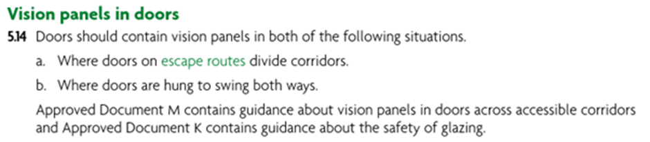

Meady Posted January 9, 2022 Report Share Posted January 9, 2022 I was wondering if you could help clarify something in ADB Vol's 1 and 2 for me please relating to the requirement for vision panels in doors in particular in schools. I can see that there is a requirement for vision panels on doors dividing corridors and doors which are hung and designed to swing both directions. But should doors which open on to stairways also include vision panels too? Quote Link to comment Share on other sites More sharing options...
AnthonyB Posted January 11, 2022 Report Share Posted January 11, 2022 It would be reasonable to say they should, but you cant say they must unless double swing. Quote Link to comment Share on other sites More sharing options...

Meady Posted January 13, 2022 Author Report Share Posted January 13, 2022 On 11/01/2022 at 21:21, AnthonyB said: It would be reasonable to say they should, but you cant say they must unless double swing. Thank you AnthonyB - the good old 'should' and 'must' scenario!! ? Quote Link to comment Share on other sites More sharing options...
Meady Posted January 13, 2022 Author Report Share Posted January 13, 2022 2 hours ago, Mike North said: That's great - thank you Mike. Quote Link to comment Share on other sites More sharing options...
