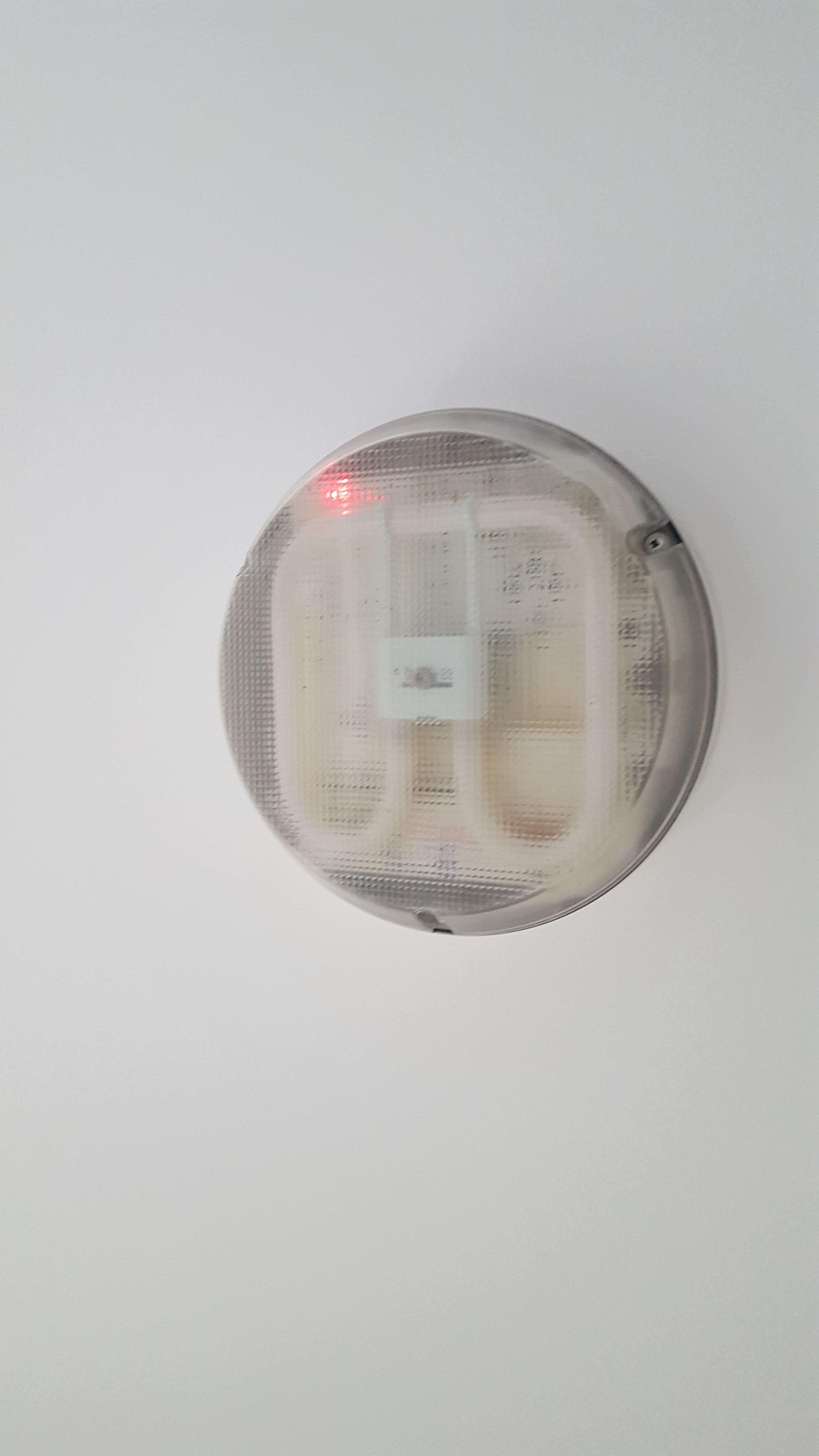

October 31, 20197 yr comment_15619 Hello I live in a block of flats with a communal staircase. On each landing there is a light but one has been displaying a red light ( see attached photo) for over two years. When I initially reported the fault to the management company I was told that it would be dealt with in a quartery inspection. Please can someone tell me if this is a fire safety light and whether the management company are legally required to maintain it? We have a communal notice board which displays info re insurance but there is no fire safety certificate on display. Many thanks. Report
October 31, 20197 yr comment_15629 The red light does not mean it's faulty, a lot of people have been conned into replacing perfectly serviceable fittings because it's red. For decades the status indicator on self contained emergency lights indicating there was a satisfactory mains power supply into the battery charger was red and it's only in recent times it has been changed on new fittings to the more logical green. As long as the light fitting works when function tested and the batteries last 3 hours when duration tested then it's completely fine. A lot of older red LED fittings remain in service Self testing units that do their own function & duration testing automatically do exist but they have several LED status lights, not just the one. Report
November 1, 20197 yr comment_15631 Further to AB submission , the RP (Management agent) has a duty to maintain/test it and there is no fire safety certificate under The Regulatory Reform (Fire Safety) Order 2005 that was the previous legislation the fire precautions act. Report
