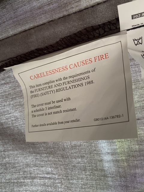

June 7, 20215 yr comment_20366 Hi all can anyone confirm that the attached sofa fire safety label covers me as a landlord ? many’s thanks Report
June 10, 20215 yr comment_20401 Unless it's specialised housing where the next level up is often required this would suffice as it's to the 1988 regulations. Report
June 12, 20215 yr comment_20429 It appears to me that the label is an e example of a shorter label which is only for use on certain items and not a sofa. I would suggest you contact the enforcing authority, Trading Standards Department or you could try FIRA Guide to the UK Regulations. Report
June 12, 20215 yr comment_20430 5 minutes ago, Tom Sutton said: It appears to me that the label is an example of a shorter label which is only for use on certain items and not a sofa. I would suggest you contact the enforcing authority, Trading Standards Department or you could try FIRA Guide to the UK Regulations. Report
