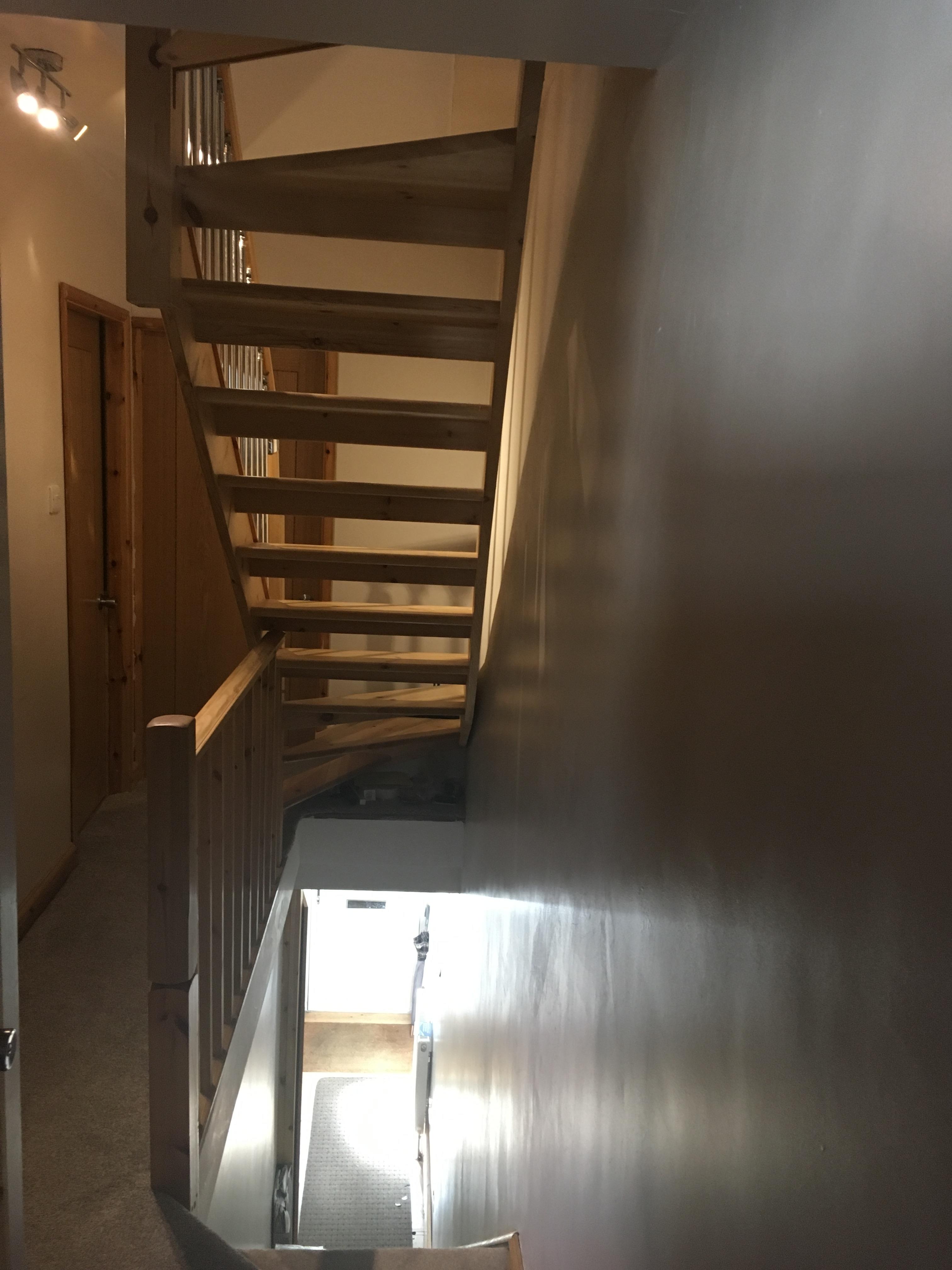

August 30, 20197 yr comment_15078 I need guidance on open thread staircases with respect fire protection in a HMO. The property is a 3 floor HMO with protected stairway and 30 mins fire door to every room. The staircase from 2nd floor to 3rd floor is an open thread wooden staircase and it is over the staircase from ground floor to 1st floor. I have just had an inspection from Council HMO officer and it was indicated that the underside of the open thread staircase need to be boarded up with plasterboard or similar to prevent smoke rise. While I do not have problem doing it, it does not make sense to me because smoke will just rise through the sides (see photo). I don’t see the need for it because the whole stairway is protected. I was wondering whether the officer is confusing this situation with when a staircase is over an area that is not part of the protected stairway as the case is with the staircase from ground floor to 1st floor which is boarded up. Is there a logical explanation to this request? Thanks Dele Report
August 31, 20197 yr comment_15098 Would it not be a better idea to get back in touch with the person/department at the council and ask them? I have to agree with you, there is no point in boarding the stairs since smoke can easily pass up the side. Report
September 1, 20197 yr comment_15105 I would agree agree with you it doesn't make sense, it would be pointless. Report
September 5, 20197 yr comment_15154 Thank you for the responses. My intention is to challenge the request but wanted to check that I have not missed an important factor Report
