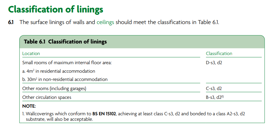

12 hours ago12 hr comment_56107 I need to replace acoustic insulation in a community room, I am looking at a widely available product containing compressed sheep's wool.Will this pass fire safety standards? Report
1 hour ago1 hr comment_56111 Depends where they are used - a quick check of manufacturer's data shows Compressed sheep's wool insulation typically carries a Euroclass E fire rating under standard EN 11925 ignitability tests making it combustible and limiting considerably it's use: It couldn't be an exposed lining and you would need to investigate if it could be used as an insulating layer of a wall/floor system where the surrounding layers are suitably rated. Report
