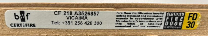

June 16, 20251 yr comment_50114 The point about a certificated fire door is that the label on the top edge of the door leaf enables you to find the certificate of approval at https://www.warringtonfire.com/certified-companies/check-a-certificate Read the certificate to find out the requirements for the smoke seals. In this way the door retains it's certification and becomes FD30(s). Report

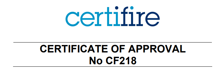

June 16, 20251 yr comment_50117 When using smoke seals care must be taken to read both the door and seal certificate. CF218 Page 5 However, CF341 So yes they are allowed, but at least one fin must be continuous Report
