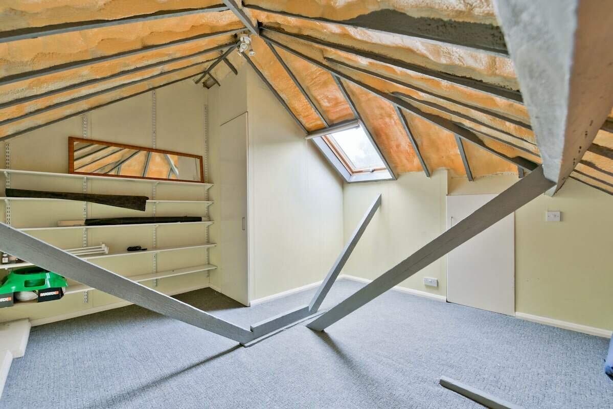

Rachel Posted July 2, 2022 Report Share Posted July 2, 2022 Could you please check pic and advise if the rigid foam insulation applied in year 2016 to roof is flammable? or could it be fire-rated? Its orange in colour now and buyer's surveyor has considered it a fire risk despite it being a residential house Quote Link to comment Share on other sites More sharing options...
green-foam Posted July 5, 2022 Report Share Posted July 5, 2022 Without knowing who made it / its specifications it is not possible to tell remotely anything about it. Quote Link to comment Share on other sites More sharing options...
AnthonyB Posted July 5, 2022 Report Share Posted July 5, 2022 It's also deprecated as a form of insulation now as it causes all sorts of problems in the house below. With no test certificate it's difficult to say. Quote Link to comment Share on other sites More sharing options...
