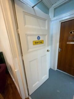

old fire doors
Guest charlottesorge@yahoo.co.uk
Without carrying out the Fire Risk Assessment and thus being able to take all the risks, layout & other precautions into account it's impossible to say.
My first concern would be if that is even a fire rated door in the first place - a closer and a sticker does not a fire door make....
