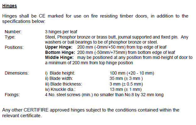

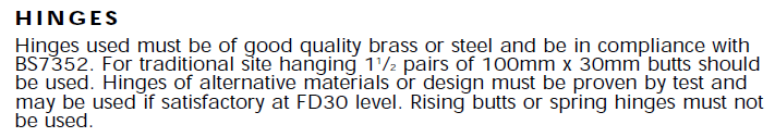

What is important is that the hinges on your fire door meet the requirements of the door leaf manufacturers installation data sheet. This is because when installing a fire door it is important to replicate what was tested in the furnace. Here is a typical manufacturer's requirement for an older fire door: image.png.6fe084c29dc7f2e4b7d4f7b88fd784aa.png
And here is one for a modern fire door: image.png.2f01cb1af1e5eb807d28a3e8cc569222.png
Clearly, when replacing hinges you should replace them all at the same time with the latest (therefore CE or UKCA marked) version of those hinges. There's more information in the Code of practice: Hardware for Fire & Escape Doors at https://docplayer.net/22285424-Code-of-practice-hardware-for-fire-and-escape-doors.html
