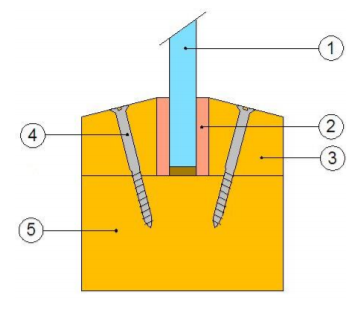

September 2, 20215 yr comment_21483 You should purchase the glass, gasket materials and glazing beads (retention system) as a complete system. Example of a fire rated glazing system below: 1) FR glass product, 2) gasket/setting system, 3) beading system, 4) fixings (including sizes and centres) and 5) framing. Start by selecting a suitably fire rated glass and consult the relevant fire resistance performance certification for details of the gasket/beading/fixings system that is necessary to suit that particular glass. Various certifications can be found at https://www.warringtoncertification.com/certified-companies/certifire/glass-and-glazing for example. Report
September 2, 20215 yr comment_21484 Thank you, it's reassuring that such a 'system' exists, rather than trying to cobble something together ourselves. Thank you for the pointers - I will do some homework based on your advice. Report
