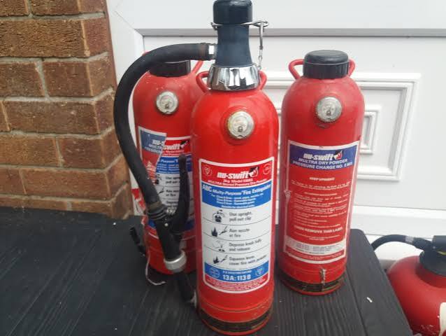

- Primary sealed powder extinguishers where the extinguisher is a sealed charge with a removable piercer valve - Essentially refers to the old Nu Swift range no longer in service - 10 year discharge test internal
Understanding Extinguisher Jargon - Extended Service

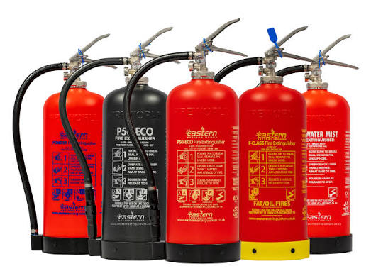

- The P50 range (which you don't need a service company for) which is also 10 years between discharge test
Eastern Extinguishers | PFAS-free P50 Fire Extinguishers
