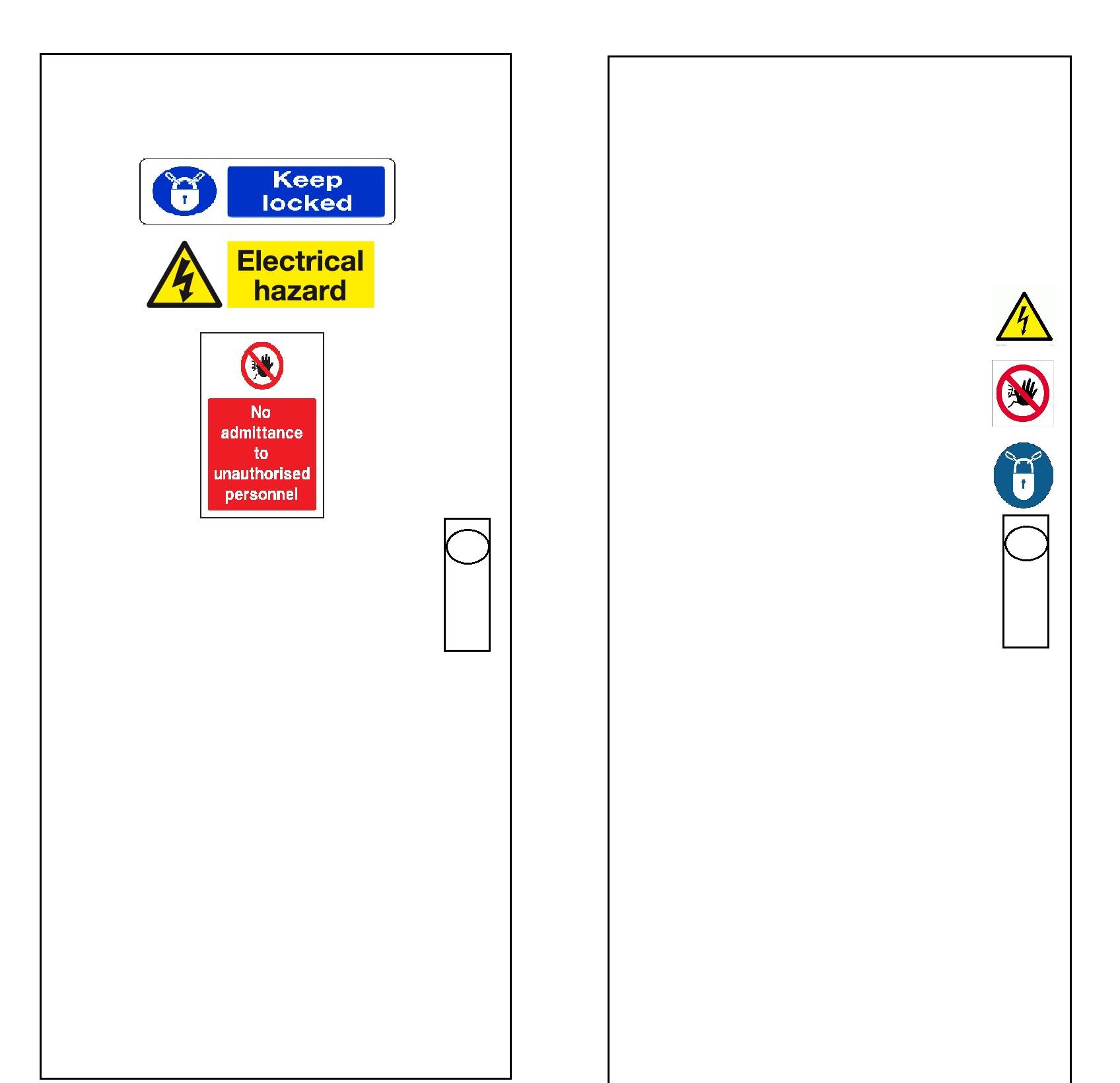

That's rather excessive - you don't need fire exit signs in simple single stair single exit buildings & glazed framed pictures and plant pots (as long as the plants are kept watered and alive) are not usually a real hazard (I'm usually happy with them).
Smoking signage is an explicit legal requirement with no get around - however the requirement for it to be at least A5 with specified text was dropped (in England) years ago so a simple 75mm or 100mm no smoking pictogram by the entrance would suffice
Other signage can and also should be sympathetic - for a typical plant room or meter cupboard there are two ways of signing them that are compliant - one of which is less institutional
