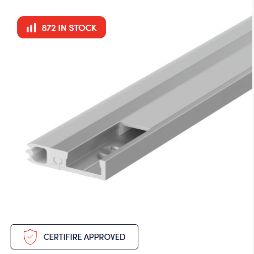

Neil ashdown Posted May 12, 2025 Report Posted May 12, 2025 You mean, in order to exceed the required Standards? There are already continuous smoke seals that reamain uninterrupted by hinges and locks because they fit to the edge of the rebate stop. https://www.lorientuk.com/products/batwing Also, ones for retrofit like this: Quote
Hugh Riddle Posted May 13, 2025 Author Report Posted May 13, 2025 Yes, forgive my toying with unbroken smoke and fire protection using the existing 10mm wide rebate, beyond the already met proportional requirement. The batwing strip seems to need a wider, deeper rebate. I've added the link I forgot to give to my last reply. Quote
Neil ashdown Posted May 14, 2025 Report Posted May 14, 2025 Thanks. Interesting, if used in place of intumescent edge seals it would be unsuitable for some fire resisting doors that specifically state a specification for the intumescent seals required. Couldn't see any link for the product certification? Quote
