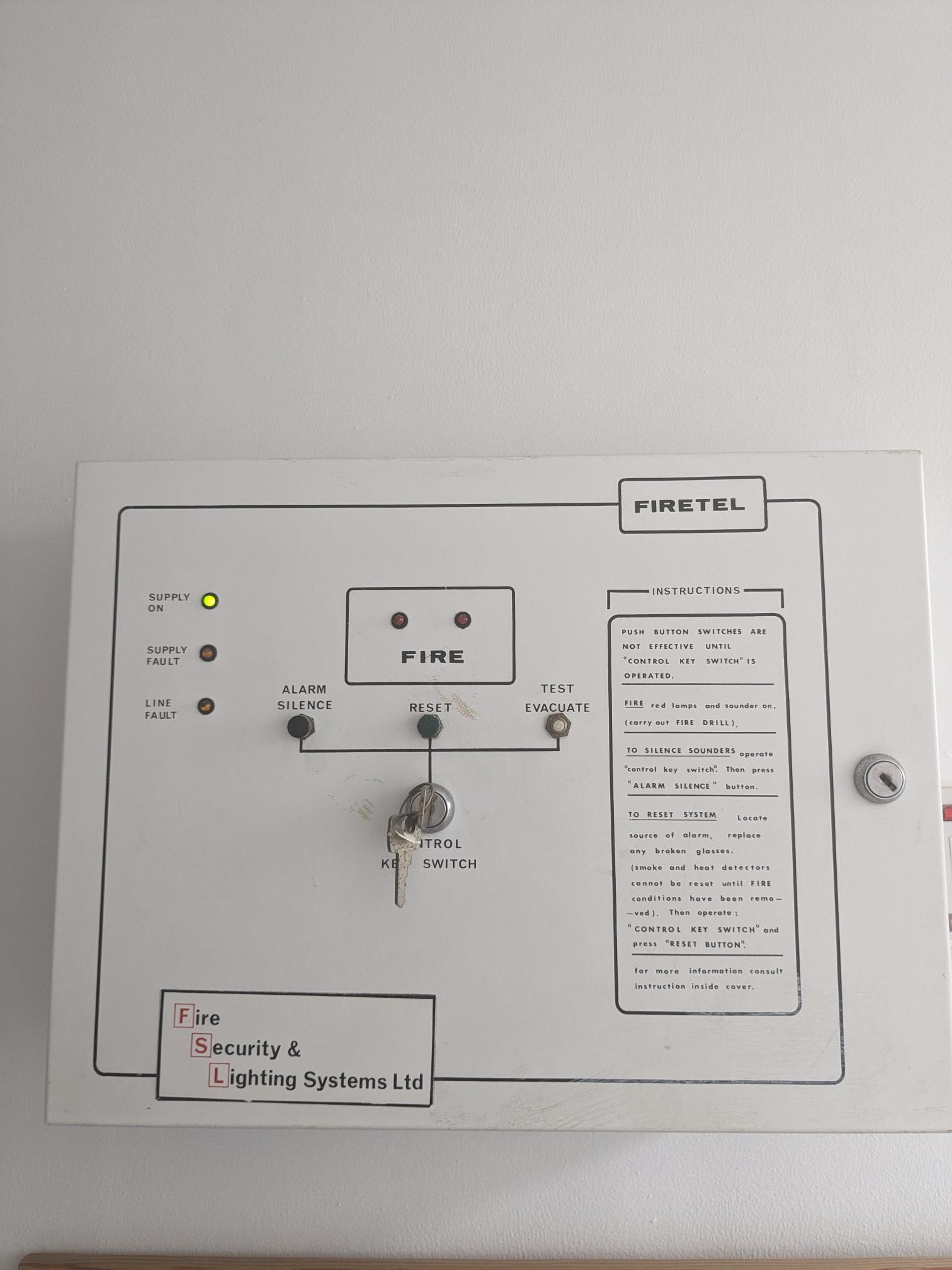

September 19, 20232 yr Author comment_38653 Hi Anthony, Thanks for the response. The property is a converted townhouse over 4 floors, one of which is a basement flat. Each floor contains a separate flat, and all are served (excl the basement) by a singe internal stairway. A photo of the current fire alarm system is below. Sounders are positioned in the stairway and can be clearly heard in each of the flats. The basement flat has its own sounder. In terms of detection, smoke detection is fitted in all flats (living rooms and bedrooms), but there is nothing in the communal staircase. Report

September 20, 20232 yr comment_38667 The assessor is correct in principle, however it may be adequate instead to expand the existing system to provide the correct cover. Regardless of whether it's done by one system or two separate systems the minimum cover would be (as has been for decades including when this would have been fitted. - Common system has detection to common stairs and hallway of each flat - 85dB at the bedroom doors from a common sounder (usually this means a sounder in each flat but you could always do an audibility test from the existing sounder location to see how loud it is when the sound gets to the bedroom doors) - If the common detector in each flat hallway is a heat (usually is but not always) then each flat would need a standalone smoke alarm in the hall. I'd extend the existing system with a couple of detectors (& if needed sounders) to achieve the physical cover above, which should be cheaper than ripping it all out and starting again. Whilst it isn't then a mixed system it provides the required level of protection - the only difference being an increased false alarm risk due to the common system having smokes in the flats. Report
