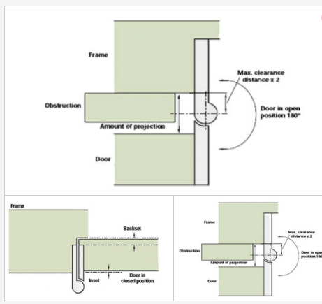

May 14, 20179 yr comment_10166 Hi i have a customer who wants a double set of door fd30 to open and fold back to the wall can this happen and what hinge would you recommend. Report
May 15, 20179 yr comment_10171 Hi Doorguy, Assuming these are cupboard doors FDKL. You need to use 'projection hinges' and as its a fire door they need to be CE marked BS EN 1935 compliant fire rated ones. Depending on the size of the doors a minimum of three hinges are required for each leaf. Report
