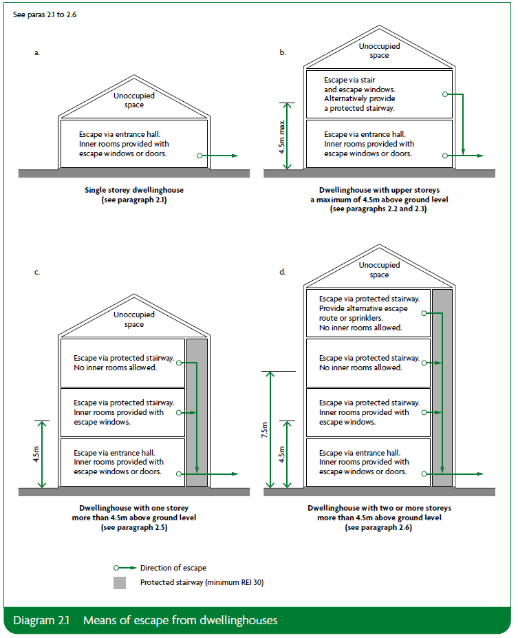

Guest Neve Cunningham Posted November 8, 2021 Report Share Posted November 8, 2021 Are fire escape rooflights in the front slope of a roof considered to be a desirable feature in a 3 storey house with a loft conversion ? Would they be recommended by a fire safety officer if it is possible to install them as an alternative means of escape if the main stairway was impassable ? Thank you. Quote Link to comment Share on other sites More sharing options...
AnthonyB Posted November 8, 2021 Report Share Posted November 8, 2021 Look here; https://assets.publishing.service.gov.uk/government/uploads/system/uploads/attachment_data/file/937931/ADB_Vol1_Dwellings_2019_edition_inc_2020_amendments.pdf Quote Link to comment Share on other sites More sharing options...
