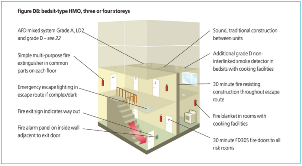

If it's existing and meets the LACORS guide for the size & use (summarised below) it's fine with just a protected internal stair that terminates in an exit.
