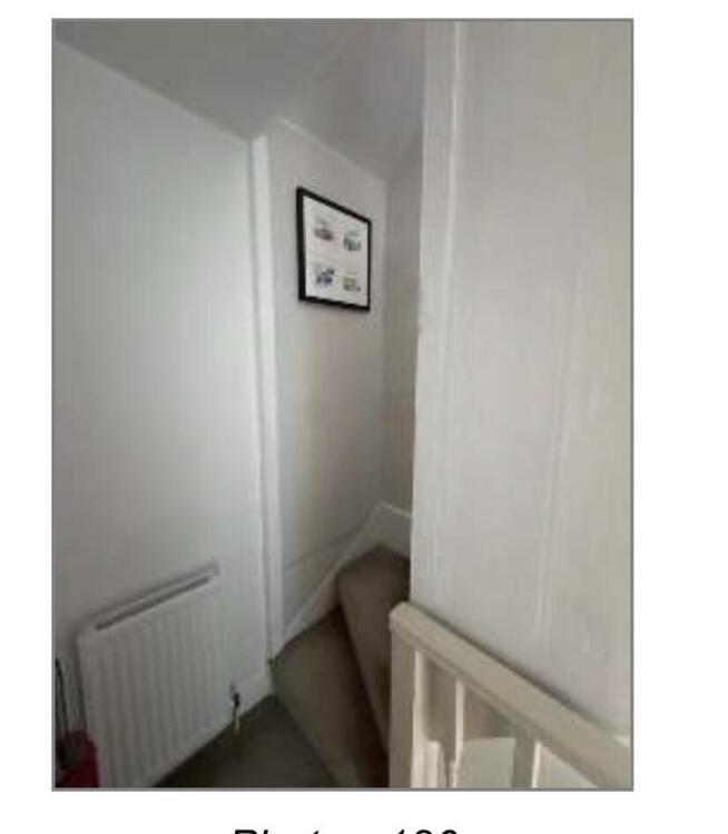

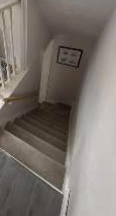

We have just put an offer in on a 1900 terraced house. The stairwell leading up to the top floor curves round and currently does not have a door on it. It is being used as a bedroom/study at the moment but we would like to get a friend in as a lodger (to help pay the mortgage)
Would the new door have to be a fire door to meet regulations? Can you get fire doors for this setup? We know we will have to move the radiator

It's really hard to see from your photos as to what else there is on the landing to the upper floor staircase - the main consideration is to have a protected escape route from the bedrooms down to the front door. So that would require the doors to the downstairs rooms (especially the kitchen) to be fire resistant, self-closing doors.
