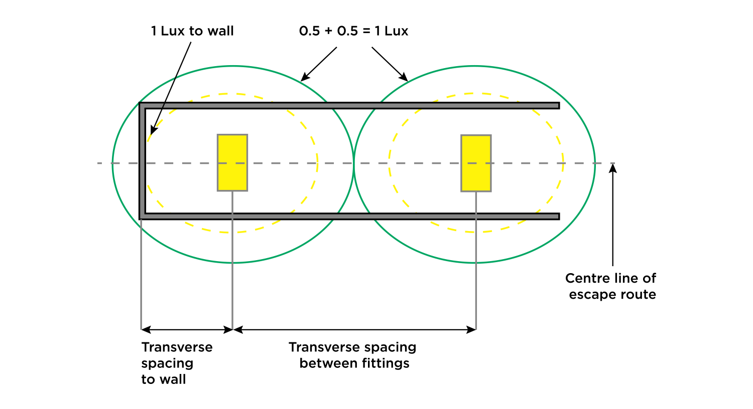

March 31, 20251 yr comment_48530 1 lux to the centre line (BS5266). When designing the lighting for an emergency escape route it is advised that achieving even distribution of illuminance throughout the escape route with 1 lux as a minimum level on the centre of line. Report
