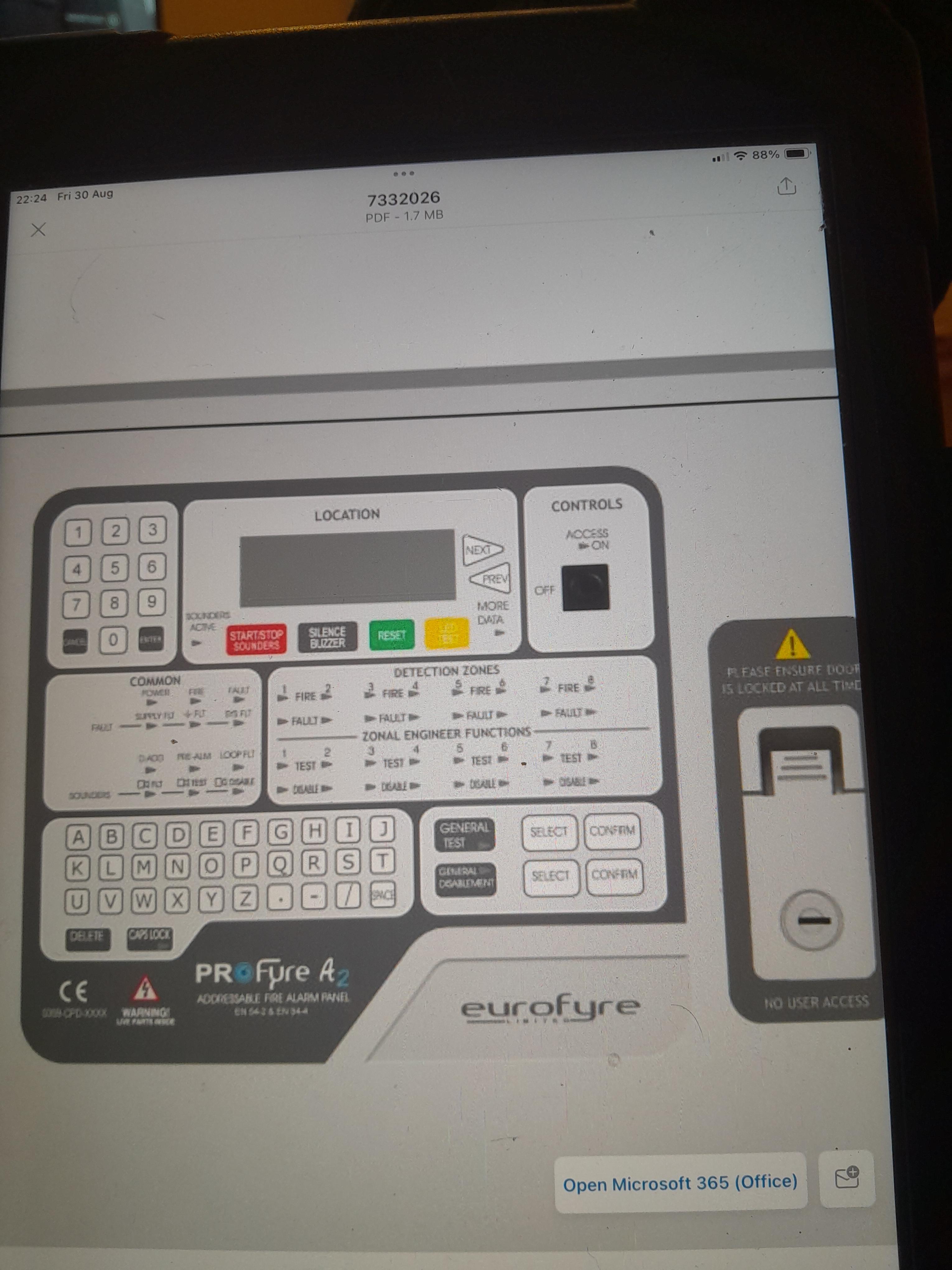

August 30, 20242 yr comment_44409 Anyone any ideas what key is used to access the controls on this panel? Report
September 4, 20242 yr comment_44465 I think it's a custom key and the panel is discontinued. There is no code override to use instead of the key and the Profyre & Profyre MKII protocols are obsolete too so they don't make a newer version, just a different one running System Sensor protocol. Shorting out the key to leave it in access level seems the only option for an engineer save replacing the lot (new panel, call points, detectors and sounders) Manuals: https://manualzz.com/doc/7332026/profyre-a2-user-manual?p=20 https://manualzz.com/doc/4159885/installation-manual?p=29 Report
