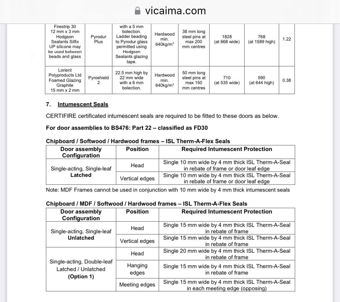

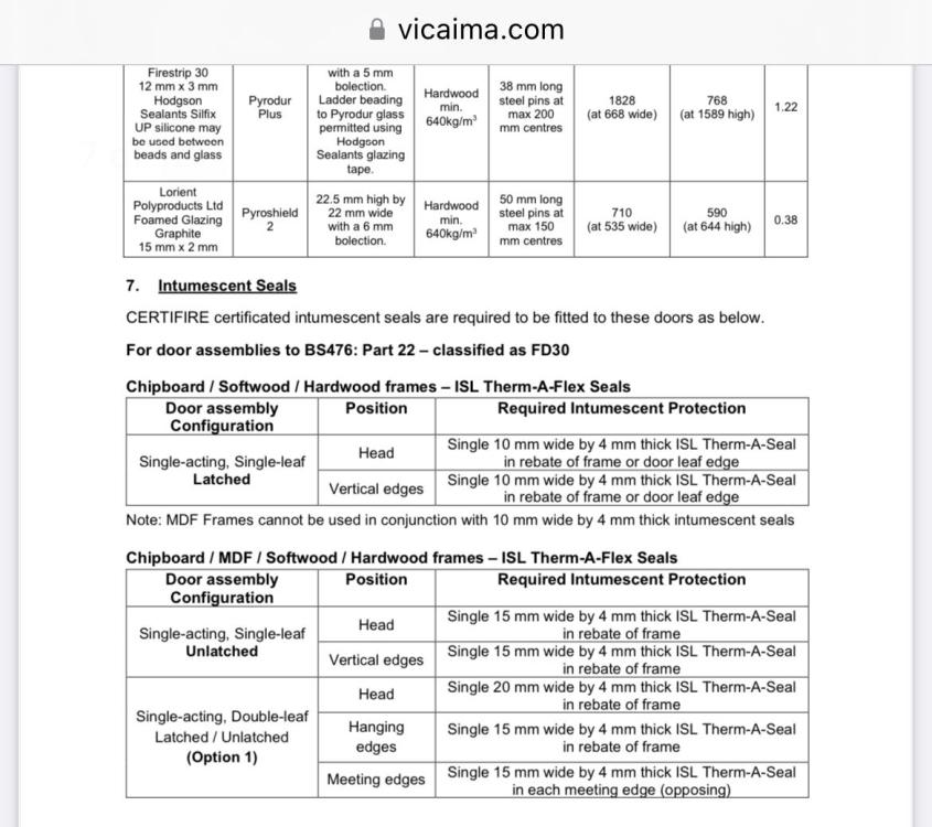

January 23, 20251 yr comment_46861 Hi Neil I have tried to email IFSA with no response I will try to ring them today, if you take a look at viacama data sheet it allows a single 15mmx4mm therm A seal, but I presume from this that only means there fire only seals. Report
January 27, 20251 yr comment_46908 So looking at this. Opposing seals are permitted, so one could be fire only and the other could be fire and smoke. Report
