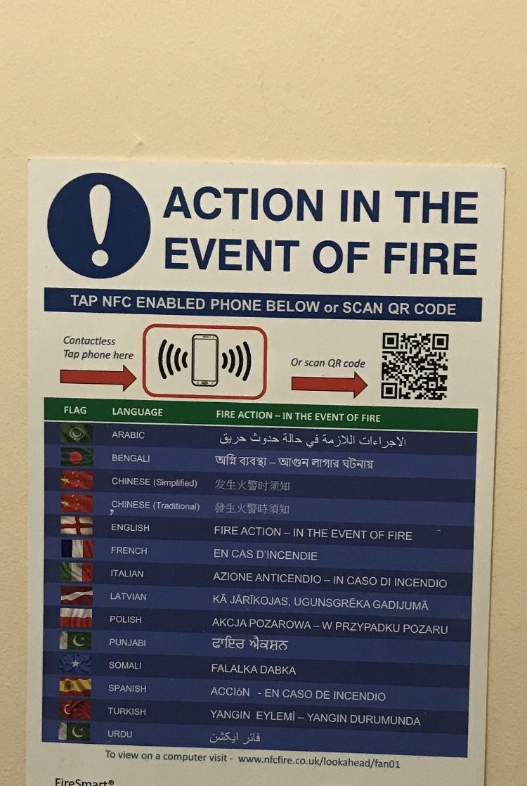

Guest Hyperion Posted January 6, 2023 Report Share Posted January 6, 2023 What’s your thoughts on these Fire Action Notices? They are the only ones in the premise. What if people don’t have a phone? Should there not be some written ones with actions and assembly point?? Quote Link to comment Share on other sites More sharing options...
Mike North Posted January 9, 2023 Report Share Posted January 9, 2023 If this is the only sign, then it does not satisfy the RRO. Fire action notice signs should be designed to clearly people with various instructions to make during a fire, including how to raise the alarm and where the closest assembly point is. Quote Link to comment Share on other sites More sharing options...
